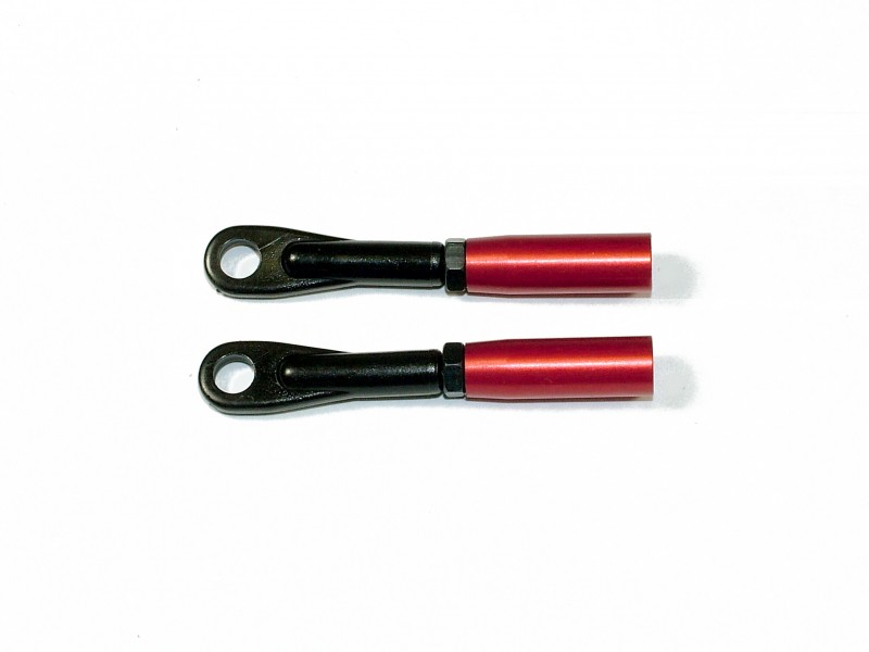

I managed to make myself a quite good setup with carbon rods from my LHS and the endings from QuickUK.
Hereīs a couple of pictures:
Lapplandicranger is offline        Reply With Quote

That looks nice and neat!
Did you weigh the 2 rods before and after by any chance?
Mick

No sorry! I didnīt. But I could remove them and weigh them and compare to the original ones.
Iīll post it here when done.

Okey, hereīs the result
Original pushrods 24,5 grams
New CF pushrods 26 grams
Iīm certain that you can cut that 1,5 gram by using 1mm smaller diameter on the CF rod.
