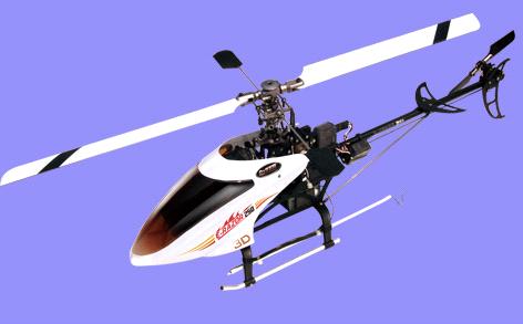

I have just purchased a Dynam E-Razor 250 and need to converse with people who have the same helo.
It is a well built heli with metal head components and carbon chassis.
I have some concerns about the manual. In fact there is a lack of manual for this heli and especially for the 2.4Ghz radio. I wonder if someone has worked it out yet.
It took me some time to realize I had to bind the radio to the 250 each and every time I turned off the radio or changed the battery in the 250. There is nothing in the manual to tell me that this is necessary. I have several other helos and haven't had to do this with any of them. Is there a way to keep it bound?
Another problem I experienced is that it seems that if the battery is a little low the servo for the tail rotor (rudder) fails to operate!
The unit does not come setup ready to fly. There is a lot to do to fine tune it.
I have tried to communicate with Dynam through their tech support to no avail (don't answer emails). Does anyone know another way to there support for this machine?
Has anyone got an exploded view of this helicopter?
Looking forward to communicating with you if you have one of these.

The photos provided don't look like a fixed pitch heli at all ...

Quote:
You are right, it is a collective...I have only just purchased it and I never really had a good look at it till you pointed it out. It was advertised as a fixed pitch and ordered as a fixed pitch so I didn't give it much thought! I actually feel foolish now as I have a Blade 400 CP but I didn't even look at the 250 that close is the reason!!!
Thanks for pointing it out.
doninoz is offline        Reply With Quote
Old 08-30-2009, 08:09 AM   #4
Steve Joblin
Posts: 3,587
Join Date: Aug 2008
Location: Blue Bell, PA USA
You aslo talk about it being 2.4 Ghz, yet that is not what the photo shows... do you have a long antenna on the heli as pictured? If so, I don't think it is a 2.4Ghz system... it is probably 72Mhz.
Also, you may be better finding support in the Align 250 or Gaui forums as Walkera doesn't really have a similar heli to this.

Quote:
Hi, yes, it is 2.4Ghz 6CH by Dynam. I I took some photos and posted them above.
The antenna is short...actually 2 strands from the receiver about 6cm long each. Pictures on the actual box it came in show a long one as the picture indicates as well as showing a 72Mhz transmitter (with long antenna).
So Dynam have it really mixed up. They emailed me stating "...the new e-razor 250 is a fixed pitch model for fliers moving from coaxial to collective. It will suit beginner to intermediate fliers..."
That's why I never really looked at it as soon as I received it believing I had a fixed pitch heli.
So they have made changes to the heli (new receiver), the transmitter (2.4Ghz) but not made changes to the manual to reflect the new system!
