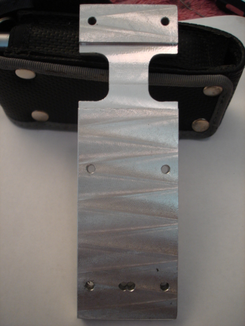

http://www.helifreak.com/showthread.php?t=184595 there you go he custom cuts the block

With the jig from AZHeliGuy you don't need to measure anything... took me about a half hour. The center part is the toughest. The jig gets you there about 90% of the way and then a small file and some fiddling gets you home.
The kit from AZHeliGuy comes with the jig, and the four longer bolts. You remove the four bolts from the existing bearing blocks and bolt the jig in place. Now you have the exact location of the bottom bearing block holes, including the center one. Drill away and remove jig. Repeat for other side. Now, use a small round file and file away a bit on the center part and install the 3rd bearing block (he gives you this as well as the bearing and an extra bearing that can be used for the top two blocks as a spare). Insert the longer main shaft before you tighten all the bolts. Once you have it all lined up, tighten down all the bolts and don't forget the loctite.
I have about 90 flights now on my 12s with the 3rd bearing block installed. I have zero slop on the head. Also, after I land, I make it a point to go to zero pitch while the blades have some energy and just listen to make sure I don't hear any squeaking from the bearings... so far so good! Big THUMBS UP to Al (AZHELIGUY) for coming up with this clever and efficient solution.
The QuickUK block looks good, but it is missing the center standoff, so it relies solely on the bolts to keep its alignment... me thinks the center standoff is a better solution.
