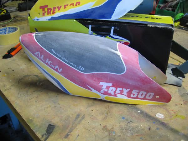

So lets get started...this is what the canopy looked like yesterday...such a shame cause the red 500 canopy looks pretty good.
Step 1: Sanding and Preparation
This is important, if you dont do this right the end result wont look as good. Get some 320 grit wet dry sand paper and sand the canopy, sand until the factory paint lines are gone...these are raised due to excess paint. get them smooth. Then wash the canopy in warm soapy water and let it dry.
